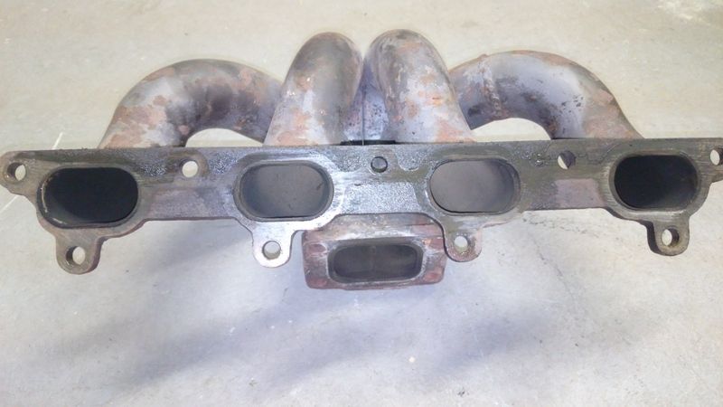

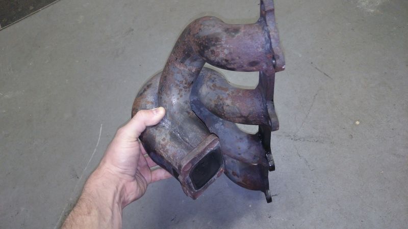

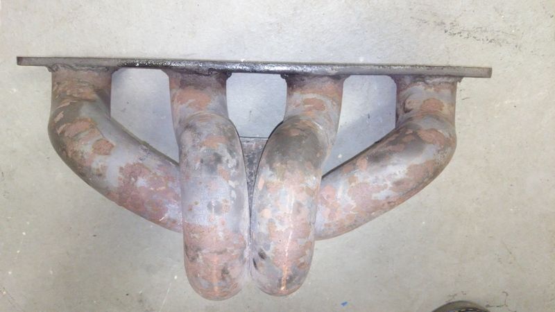

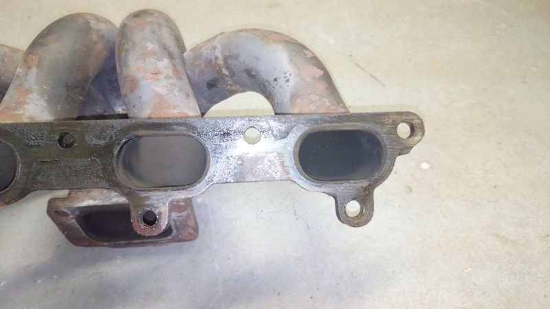

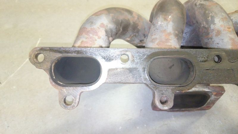

Here's what i used for exhaust manifold, modified ebay gem. started as this, and hits water pump neck, with a t3 flange (start t4 if you want great top end)
To this.
