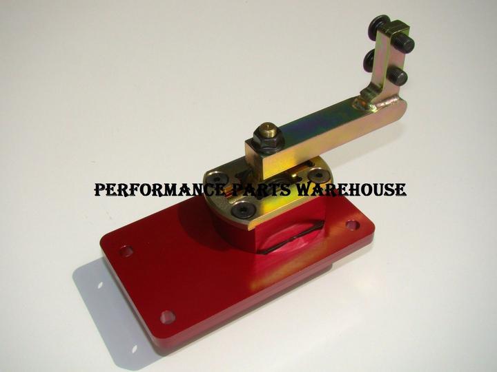

Did you do an engine refresh (bearings, seals) or is it bone stock "as found"? Please take some pics of your T5 and show the shifter mounting details..... I'll be doing the same thing on my 242 which will get the T5 gear box (to start off).
I'm sure you tried, but was there any hope of moving engine/trans more aft? Or were you against the firewall / bellhousing?Here are pics of the trans/shifter location:
This plate moved the shifter handle back to where it was before, but shifting into 2/4/R really pulls on the rubber shifter boot, so I may drill another set of holes halfway between.
