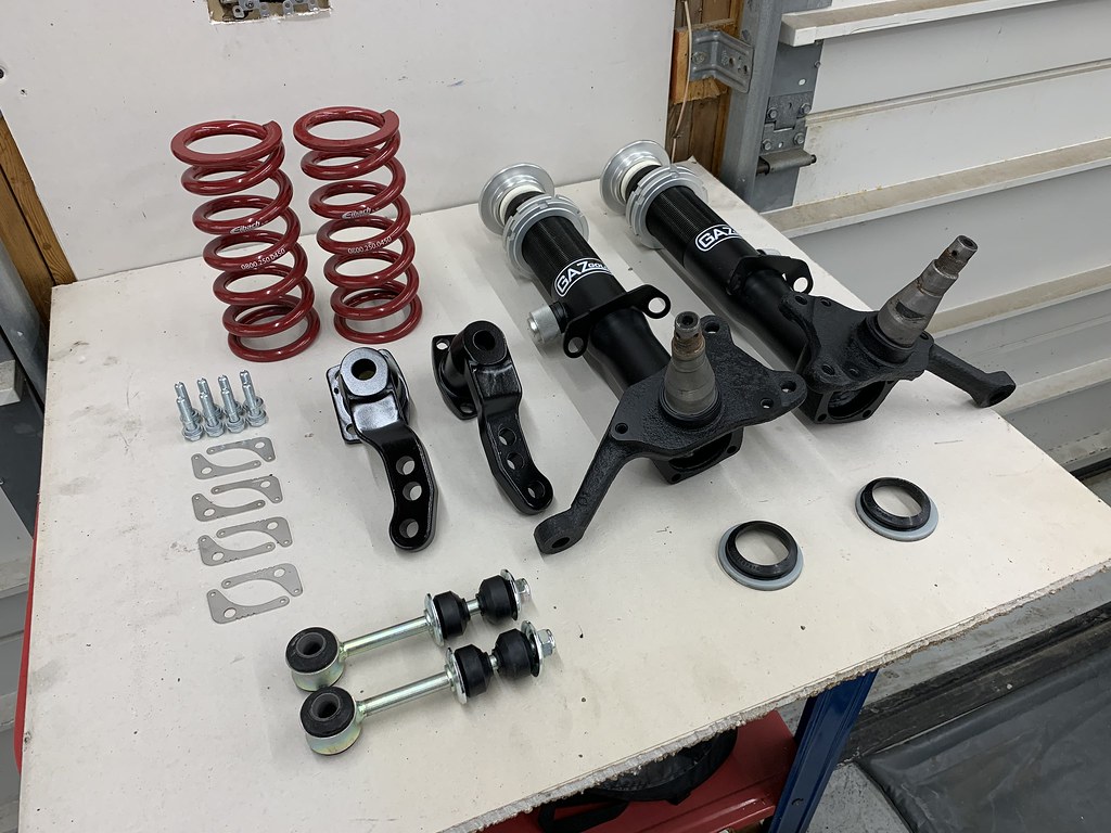

I picked up V2 QSRC's from Ben, as well as a set of GAZ GOLD coilovers from Classic Swede. I had been waiting a couple months for the coilovers to be built and arrive. Lo and behold they arrived on day 1 of the work-from-home mandate.
The V2 QRSC have adjustable Ackerman, as provisioned by these alignment plates.
Note for myself (and anyone else who buys these, because it's not documented anywhere): Per Ben, V2 QRSCs have 5 degrees built into the plate with 1 notch when used with the middle tie rod hole. The notches (1,2,3,4) represent angular displacement from 0 towards the outside, with 1 notch being the plate that matches "stock" Ackerman.

Quick shot of the setup I'll be running. GAZ GOLD coilover with 450lb main spring, helper spring and the same group a++ top mounts I was running.
Comparison of old and new. The Koni are very short, IIRC 3.5-3.75" shorter than stock. The GAZ are about an inch longer, which should better suit my ride height.

Gratuitous shot of new endlink and the wonderful adjustment knob on the GAZ body.
