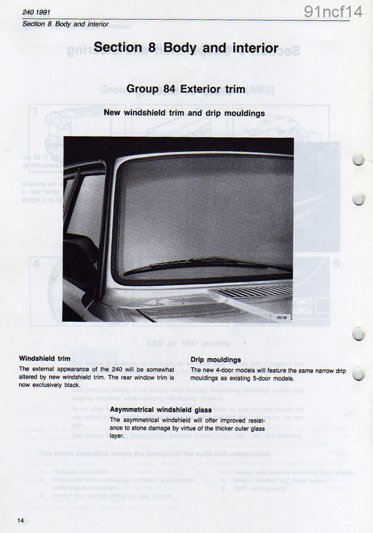

I understand the 1990+ 240 windshield fits into the older cars,
and is an improvement. Can anyone confirm this?

Yes.
The back glass just ropes in.
I'd get one at the JY and rope it in.

I've heard the same about the the 90+ windshield, but actually want to keep the older style so I can retain my big clunky chrome trim (to match all the other clunky chrome trim on the car).

I explained that he could use the 1991+ windshield, and the guy was intrigued, apparently the old set-up is a bit of a pain to install. He is going to order both, just in case.
I don't think they would have a problem replacing the old screens with the chrome trim.

i've replaced a few 240 windshields. it can be problematic finding the clips for the old style windshield that hold in the chrome trim - so the glass shops will try to glue it in instead, which never works well long term, you have to insist on getting the clips from the dealer to hold the chrome on - if that's even possible anymore
the 91+ windshields fit pre 80 cars and the shops do prefer to install them because they go in much easier with the glue, and the trim rings are obtainable and meant to be glued in. You have to make sure they order the trim rings appropriate for the windshield.
the rubber gaskets for the older style windshields eventually fail and start to peel away from the frame of the car leaving oppertunistic spaces for rust. wind resistance, noise and leaks are all a good reason to upgrade to 91+.
the last time I had to get a windshield on the 83 242 the insurance company didn't want to put in a 91+ windshield because it wasn't "original equipment" - till they saw how much more it was going to cost them to get everything for the 83 model and they had to special order the clips from volvo. it changed their mind pretty quick on letting me put in the upgraded windshield.

They were fully prepared to replace the windshield with the old
style. When I explained that Volvo recommends the 1991+ glass,
the guy said he would order both, and install the '91+ if it
fit up properly dry.
Well, it fit up, and cost $75 less.
