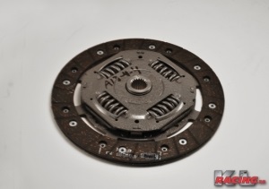

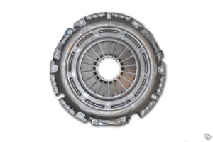

With the 240mm clutches, none of them are spring-loaded. This results in bearing noise from the transmission. Plus, these clutches don’t last much longer than the 228mm ones. The M90 transmission is the limiting factor anyway. But again: see for yourself. :)
A completely original B230FK cylinder head (340,000 km) fitted with a T2 camshaft.
Best Regards, ludi
Oh, I didn't know that. If that's the case, I thought the 240 mm setup was far superior. That would change things, because I recently put a new 228 mm clutch with pressure plate, bearing, etc. in my car.
Can you maybe recommend a clutch setup that is head on with the limit of what the M90 is capable of holding? Maybe I could reuse some parts and save some money :x:
