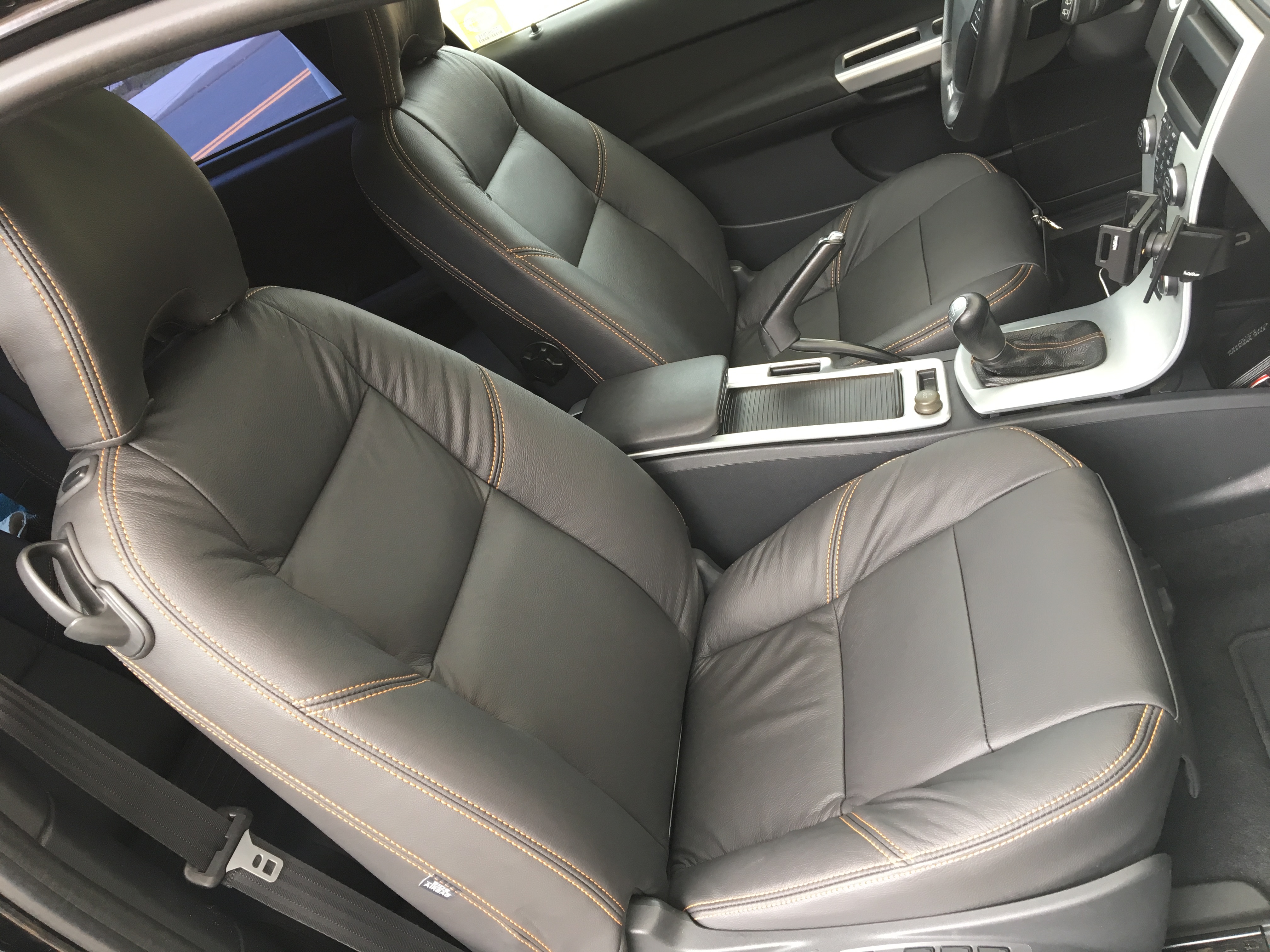

Finished up the driver's seat & installed. Have to futz with the seat module some more - I clearly didn't fully lobotomize it like the passenger one.

The covers look like they are loose on the bolsters, is that how it is, or is it just the pictures?
I think I saw someone using a steamer on job like this to take out the wrinkles and "shrink" the covers tight.
he said this earlier "Passenger seat finished & installed. Still do have to heat & smooth the leather some more" I think he means he's going to steam them to shrink to fit.

They are listed for S40/V50, Ridies.com doesn't have a listing for C30 - I was under the impression that the only difference was the C30 back release that is not present on S/V P1s. They definitely don't fit as snug as the CanadaSeatSkins version I bought years ago for my C30, and the cut is different on the bolsters. That said, in the pic above I hadn't yet pulled the seat back tight though to the rear panel. There is still more loose leather at the base of the back bolsters though. I'll have to look into using a steamer, I'm not going to be happy with them having all the wrinkles.
