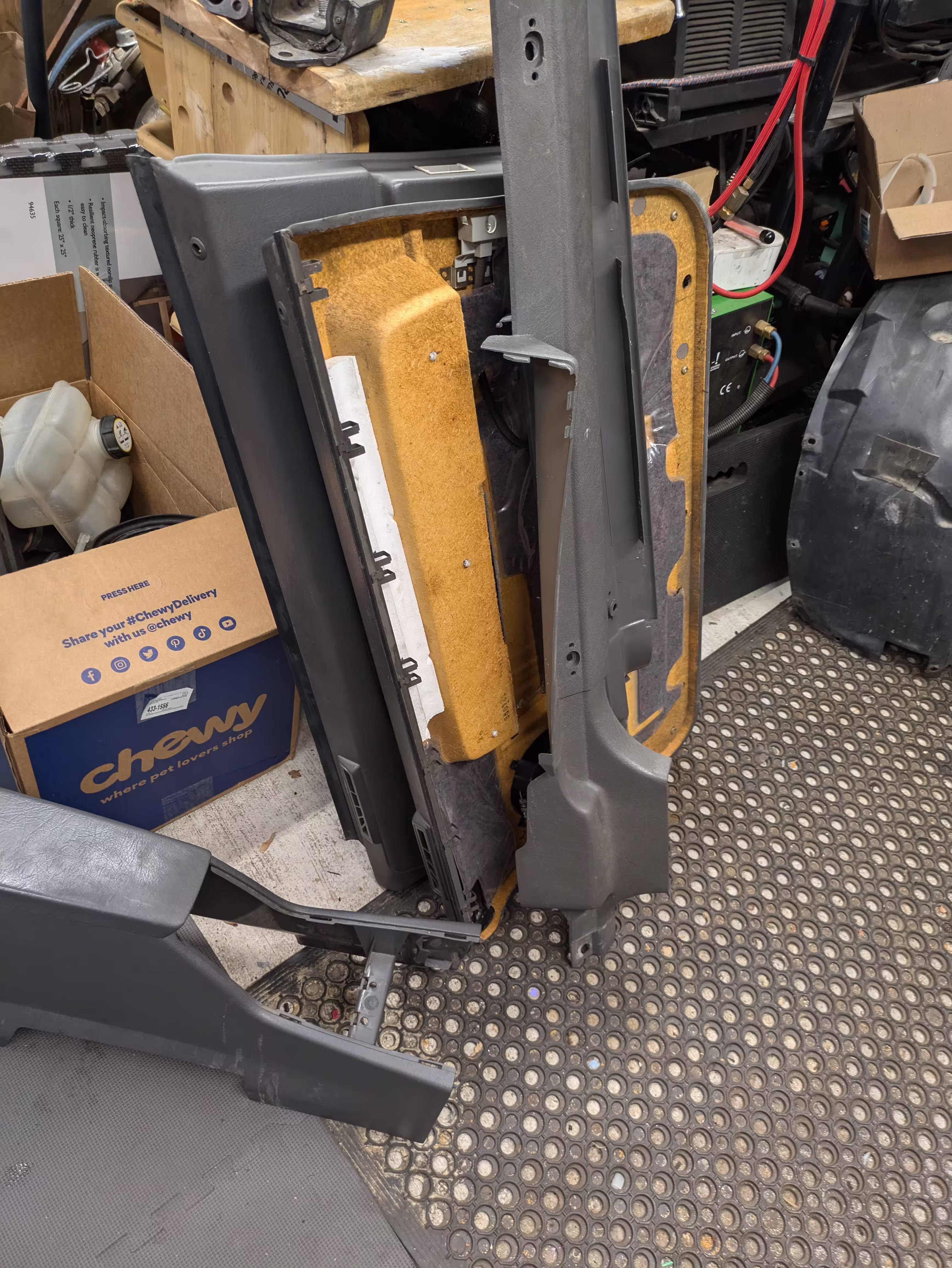

Door panels, sill covers, center console. I'll swap out the black for these.

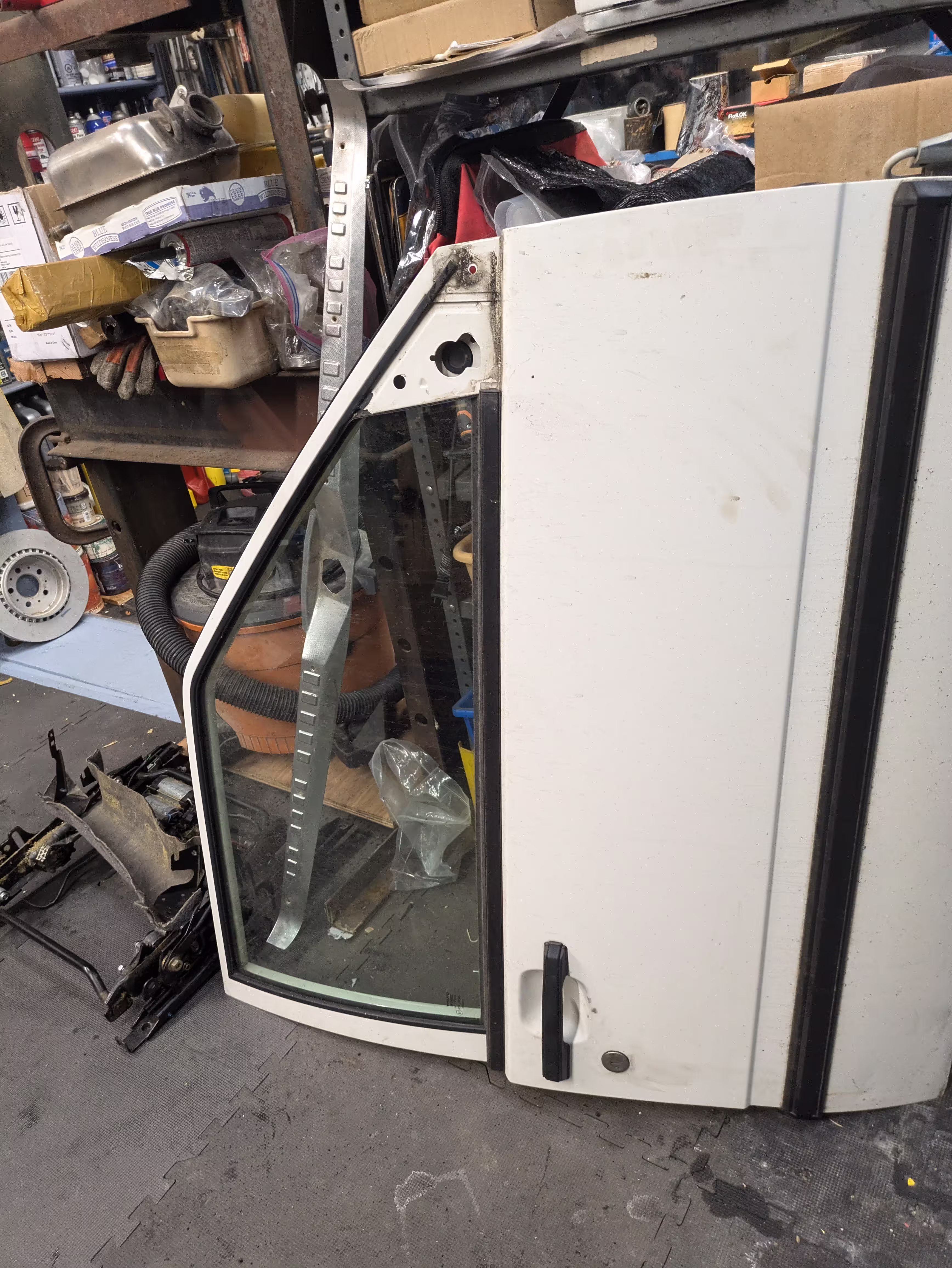

doors seams are perfect, no rust

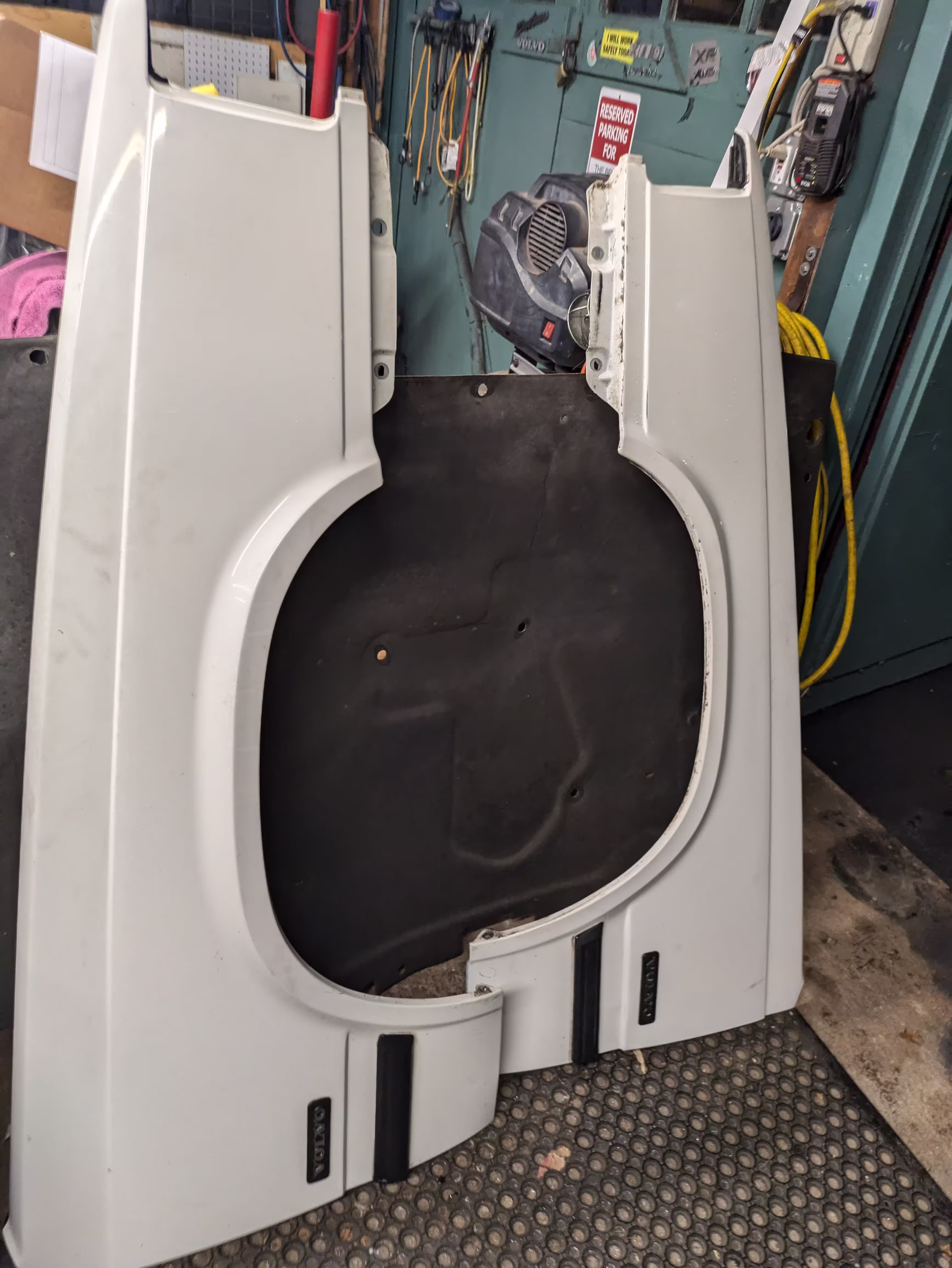

Front fenders were also dent & rust free, so I got those as well. Can't pass on great condition sheet metal

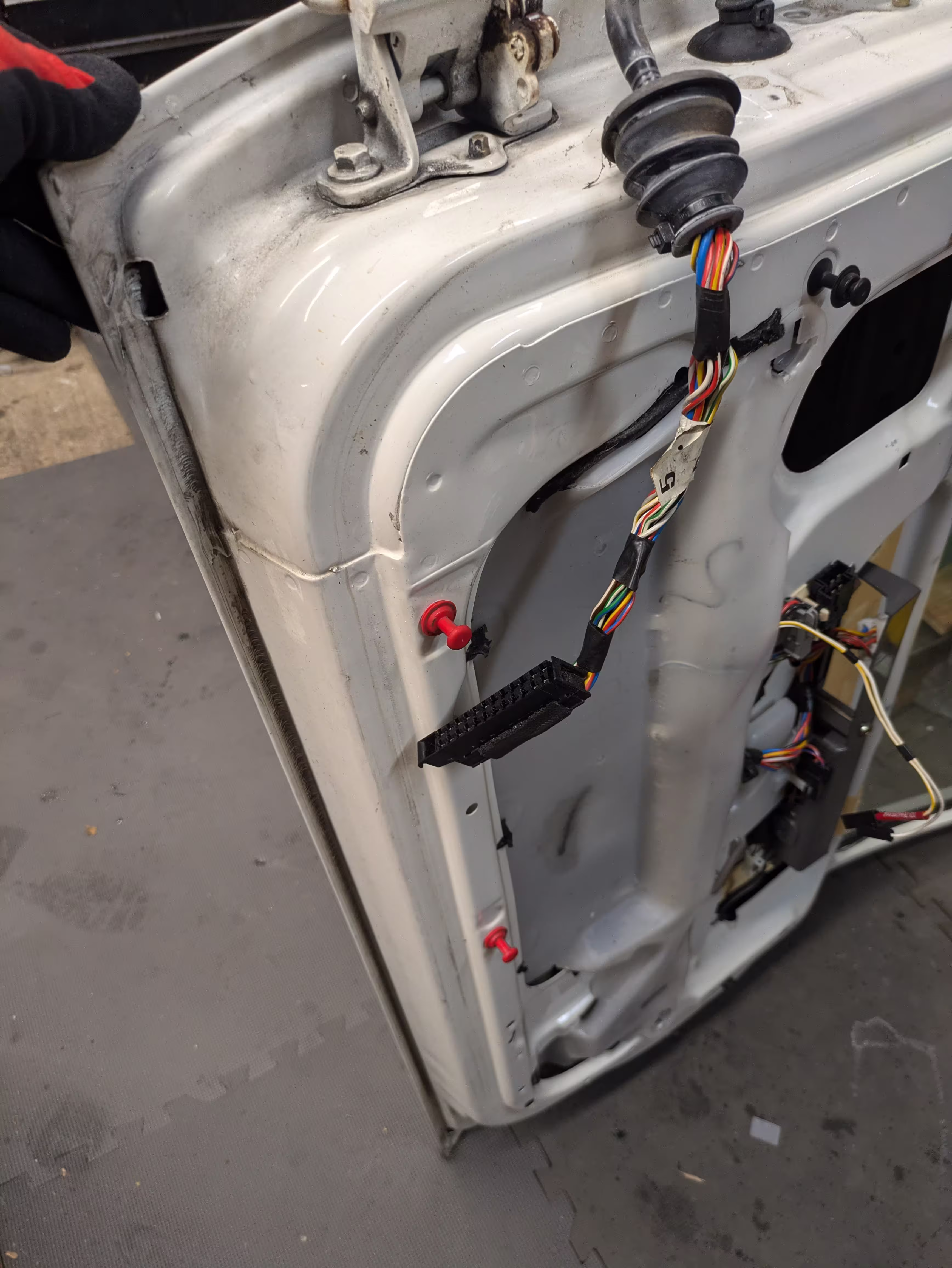

Had a hand today to get the 2 doors on. Removed the moldings & cleaned them up, installed the moldings from the old doors. Have to swap over the white door handles, rewire the passenger door harness connector, clean up the door panels, drill & mount the grab handles
I'm not planning on repainting the truck, but maybe I'll paint the window frame blue/green

Transferred the lock cylinder & added the keyless entry motor & linkage I had added to the old door
