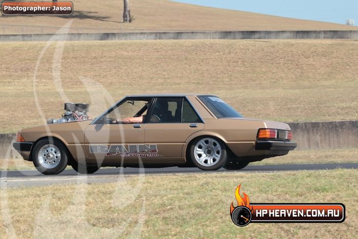

I'm going to do it up a bit racing style as the red shell was meant to be a rally car but thankfully never happened. And possibly run these 17's like on the rear of this car here.

looks like it will be a great fun project alex! You should get a great car out of the 2 of them. Not a massive fan of the 17" rims u are looking at though...

I don't think the proposed wheels will suit the period of the car either. Are they territory wheels?

in recent months I've seen a lot of modern steelies on pushrod volvos. Every time, before seeing it, I've gone "hmmm, dunno if that'll work" and every time, like clockwork, it's looked spectacular. I'm tempted to say that this will be an exception, but again, am looking forward to being proven wrong.
Yeah they are, I'm thinking they might not work either, and will only get some if I get them cheaper then the going rate so I can sell them on again. Otherwise, Falcon Steelies would work on it maybe, I'll just experiement, but not for a long time, need to get the car apart etc.
