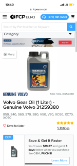

So sorry to make a double post but Volvo has updated part numbers for the transmission fluid for the 745 I’ll update when I have bottles in hand. It does say gl5
