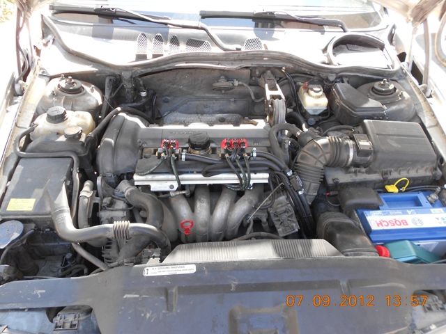

The Advance Auto battery in my 240 as of now is 4 years old. I suspect it'll die this winter or 1st of srring. We'll see.......

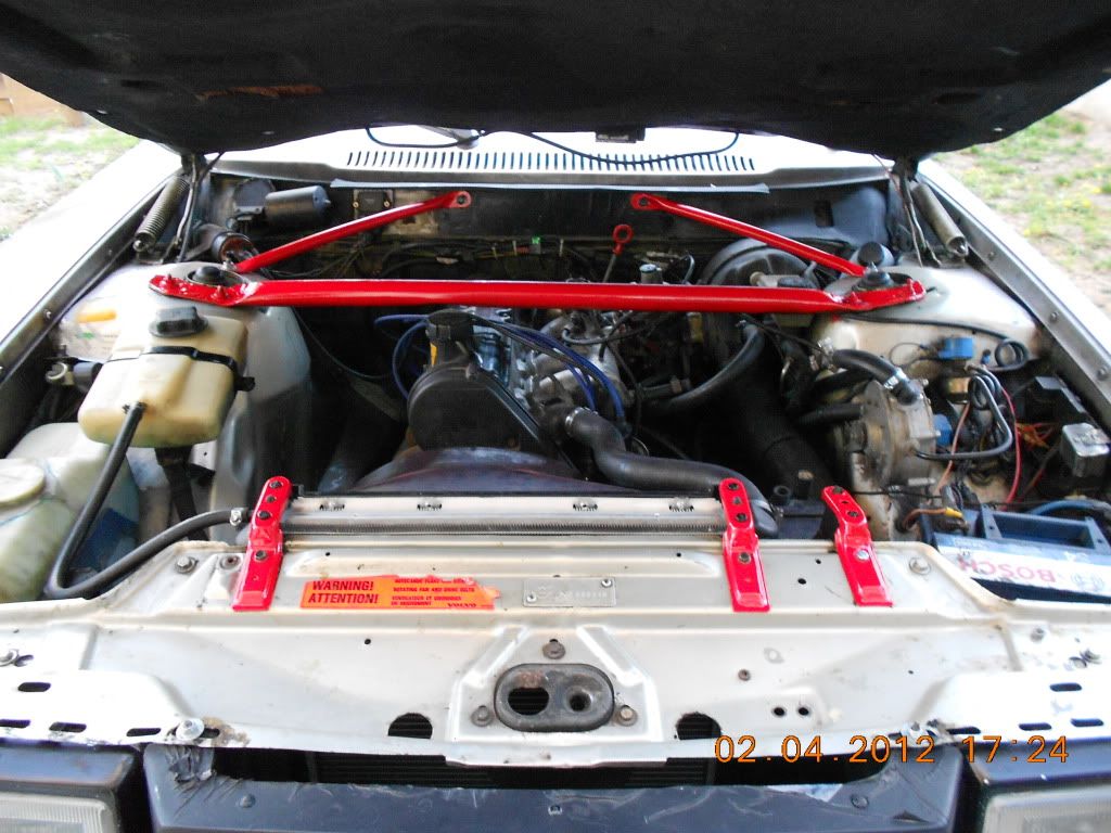

had it on 240 also (for years ) and cold cold winters never an issue
