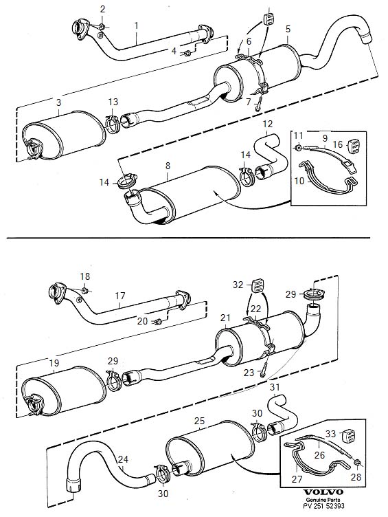

I have no idea about the 204GT/FT engines, but I like to go through part catalogues.
The 204GT indeed has no cat, while the 204FT does.
The GT has an additional silencer in place of the cat.
The EZK is the same part number for both GT and FT - p/n 3531520.
204GT:
204FT:
EZK part 13 on the list right at the bottom 3531520.
