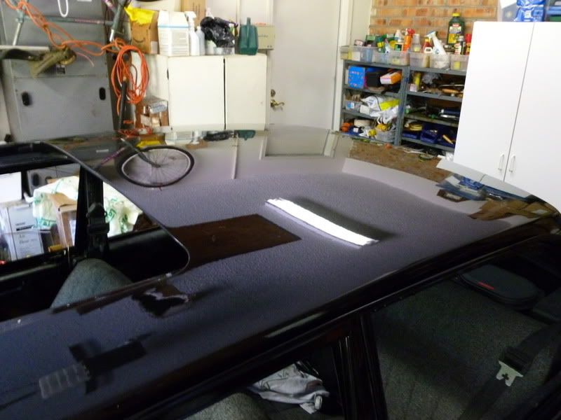

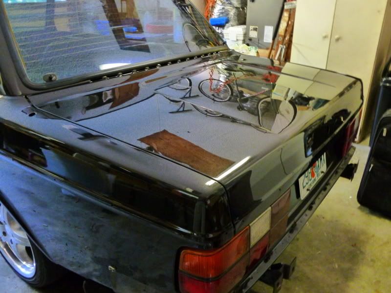

After being at the boy shop for over a month, I finally got to pick it up yesterday. Totally worth the wait :) I'm only up in Jax for the weekend though so it might be slow going for a bit. But a couple teaser shots are in order here....
total was just south of $1100. That's new paint from the belt line up, a new hood that had to be painted top and bottom, then aligned, and 3 spots of coin sized rust repair throughout the body (done the right way). I got lucky cause I think business was slow when he gave me the bid and he went a little lower. Then there was also the new windshield and pulling then reinstalling the rear window that I had to pay to the glass guy.

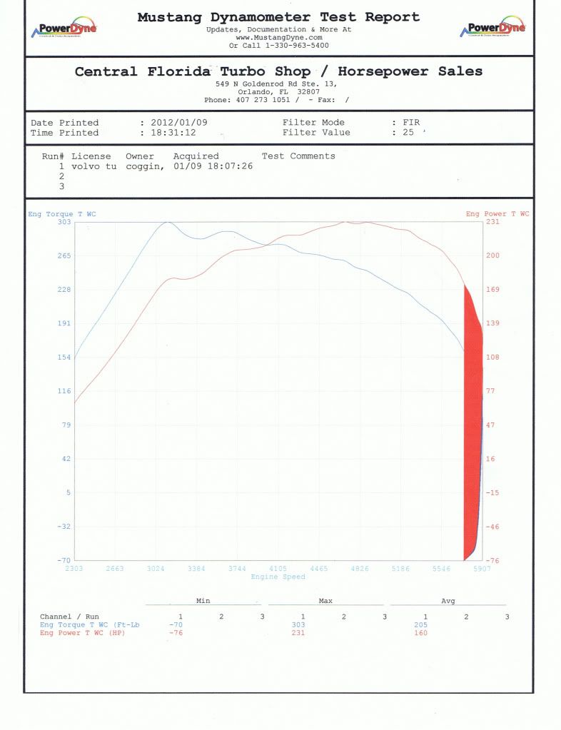

Been back in Jacksonville working on the car for a few weeks of winter break. Got it put back together after paint, replaced a buggy LC-1 controller, and ironed out the last of the quirks and kinks with the car. I drove down to Central Florida Turbo today to dial in the power on the dyno with Rolo, the tuner. First pull produced 190 HP and 260 ft lbs, and the graph below is the final run we did. Broke 300 ft lbs! At 3100 rpm lol! I had no idea it'd make that kind of torque, and I'm really glad the M46 held up under that. I've got a video I'll get up soon.
