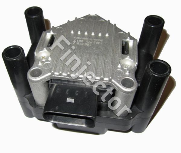

VW wasted spark coil with integrated amplifier. Cheap, simple and good.
