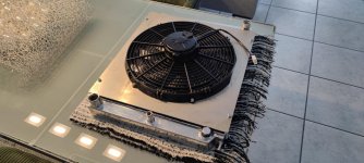

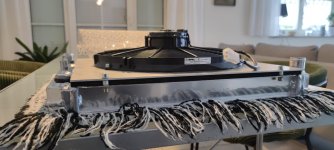

In my opinion, the problem isn’t with your radiator, but with your fan. Either your fan’s viscous clutch isn’t working properly, or the system has reached its limits. Electric fans are a good alternative for achieving high airflow at low engine loads. I use a very large one from SPAL with a radiator from KLRacing and have no problems – though I must also say that I don’t have air conditioning. Important for this type of configuration: Do not simply mount the electric fan directly onto the cooling surface; instead, use a frame to create a gap between the fan and the radiator, allowing air to flow across the entire cooling surface.
