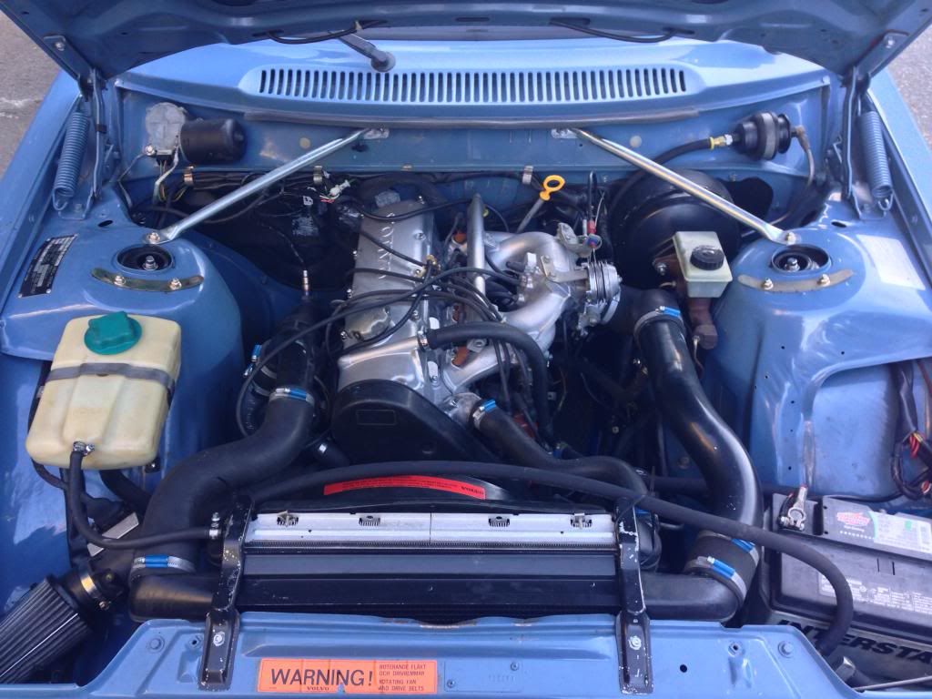

The current modlist/resto points: 1979 242 DL with sunroof
Engine
Block
Unknown mile ’93 240 squirter block (no ridges!)
IPD oil pump shaft reinforcement collar
IPD oil pump relief valve spring
ARP head studs
do88 740 coolant hoses
Hepu water pump
Volvo/VDO 10 bar Oil Pressure Sender
Walbro 450 pump with a bunch of JIC fittings
Fuel pump 12AWG wiring upgrade
Stock FT Pistons, Mahle rings
SPM rods
9.46:1 SCR
Head
B234F cylinder head; stiff valve springs VW ABA lifters
<strike>Reground cams (Techtonics 276* Race copy) w/ lash caps</strike> UA cams
Mild cleanup work on the intake bowls
eBay adjustable cam gears
Culberbone Tuning intake manifold (B234F+Yoshifab plenum+ shortened runners)
960 throttle body
Turbo Stuff
eBay (Powermaxturbos_us) GTX3071R gen 2 clone, with .64 AR turbine housing
Ported 90+ exhaust manifold with M10x1.25 studs and welded cracks. Nord Lock washers on all the things
TiAL MV-R watercooled wastegate
Yoshifab adapter plate
KL Racing intercooler
Top cover/bracket by Chris Miranda
Culberbone Tuning intercooler piping
AEM air filter
Forge 007 CBV
3" exhaust (half cobbled, cat back by JT Tuning)
Management/Fuel/Spark
ID1300x injectors
MS3x, 4 bar MAP, knock input board
AEM failsafe wideband
Yoshifab CAS adapter with hires wheel
LS2 coils
GM IAT and CLT
LH2.4 IAC
3 port mac valve
dual VSS input
eBay fuel rail
Fuelab adjustable FPR
Cooling
do88 radiator
do88 coolant hoses
Summit Racing oil filter relocation kit; push lok fittings and some proper hose
OEM 240T oil cooler
940T fan
960 coolant overflow reservoir
STS Machining bulkhead coolant hose fittings in stainless
Little things
Poly accessory bushings
AC
Drivetrain
3/2017: T-5 Swap
1352-260 T5 rebuilt by Culberbone Tuning
Redline ATF
5speeds.com OG cluster gear stabilizer plate
10-spline V8 input shaft
Hurst Shifter
Avalanche redblock adapter
Yoshifab steel flywheel
Yoshifab/Clutch Masters FX250 clutch
Yoshifab spaced release bearing
Timken 9103PP pilot bearing
STS Machining crossmember
T56 Polyurethane trans mount
M90 clutch fork
Wilwood 5/8" Master cylinder
Volvo 740 clutch slave cylinder
-4AN clutch line in stainless with banjo fittings
New reverse light wiring harness
Shortened/rebuilt driveshaft with Jao 940T center support bearing conversion
Big giant slip yoke from a minivan
trans counterweight
3.73 240T 1031 rear end + Truetrac
Suspension/Steering
BMW BBS Style 42 wheels, 17x8" ET20 with 225/45R17 Michelin Pilot Sport 4S
Motorsport Tech 20mm adapters
Ipd front sway bar
19mm rear bar
GAZ Gold coilovers with H&R 2.5x8" 450 lb-in springs
BNE Rear adjustable spring perches with H&R 5x9.5" 200 lb-in springs
GAZ Gold rear shocks
BNE roll center kit
BNE split brake line clamps
BNE Select camber plates
BNE Comfort torque rods
Adjustable panhard bar with poly bushings
Luxesteer
KL Racing front control arms with delrin front and Superpro cup bushings in the back
Fresh OE Volvo axle bushings
Heim jointed adjustable trailing arms
IPD lower chassis braces
BNE strut tower and firewall brace
BNE brake booster brace
Brakes
Front IPD SS brake lines (stock rubbers out back)
R brakes (painted) with STS brackets all around
Centric ceramic pads
Standard whatever rotors
Mustang master cylinder
New hard lines made by me (scary)
[Electrical/Body
Turbo front spoiler
Turbo rear cover panel
"TV Screen" rectangular e-codes
Euro side markers
Late battery tray
New starter
IPD Skidplate
GM DR44 alternator
New 91+ windshield
Underhood dynamat (also put the remainder under the trunk)
Bertone trunk carpeting
An absolute **** ton of sound deadening and heat shielding
Interior

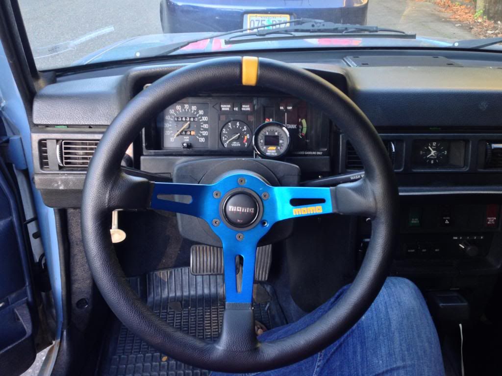

1993 R134A air conditioning system!!!!!
Volvo R-Sport Gauge Cluster, with LEDs (restored by Roger, RP80242GT+T on TB)
Recaro LS seats
Momo Super Grand Prix
Hurst shifter
Alcantara boot
Bertone door panels with power window conversion
Mint dash
Felt underdash panels
Dash coin tray
Working moonroof
Late model carpet
New heater valve (adapted new Daimler unit)
New heater core
New blower motor
New heater hoses
PWM heater fan controller
New driver's door handle
New driver's door hinge
Stereo
Kenwood KDC-X998 head unit
CDT 4” front components
JL C2 6x9” coaxials on the deck
Kicker 10” subwoofer
Kicker CX300 4-channel amp
Kicker DX250 sub amp
Custom trunk box for amp and little odds and ends
S60R horns
The stuff that needs my attention
rear butt cheeks have dents
driver door has some missing paint
paint getting thin+doors+dents

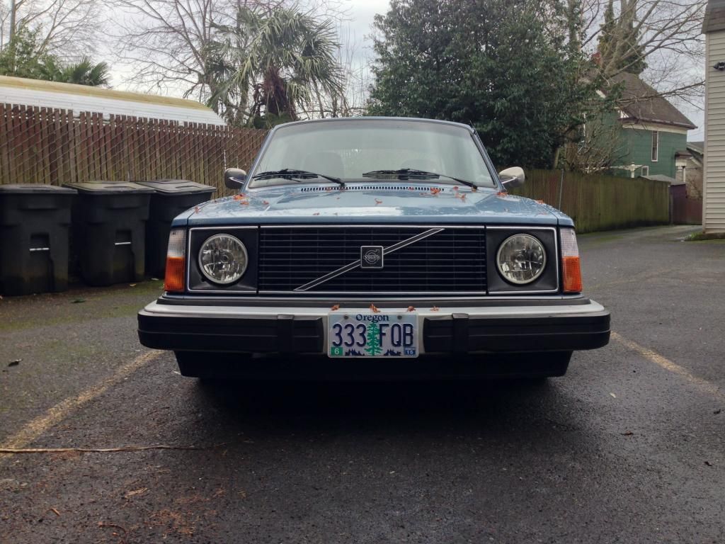

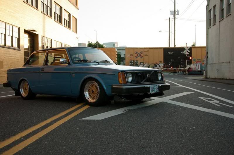

Picked it up like this from Asher (RvolvoR) in April of 2014. It had a bunch of the basics of what I wanted out of my next car and it was a good deal. Hated the Sawblades so they were the first thing to go (by which I mean, I bought the car with no wheels).

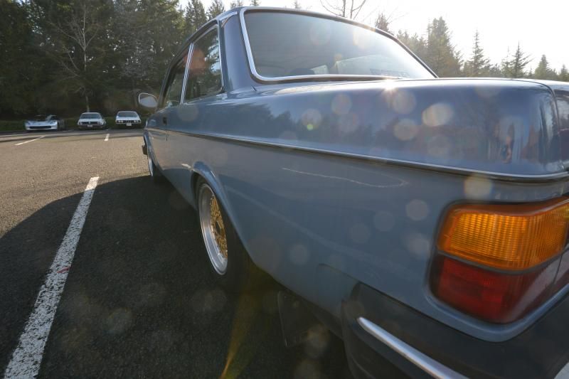

Enter new wheels
Yep, they will do nicely. Front end came up and 8" springs were installed afterward
Rocked it like this all summer. Rear end was clunky, and the wheels weren't filling the fender gaps though...Since then I have been tweaking a bunch of things that I wasn't happy with. Swapped the grille for a prefect one, added H4 headlamps, swapped euro corner lenses, added a Turbo chin spoiler, spaced out the rear wheels 25mm on each side, moved the rear axle forward 15mm, then put in an NPR IC and RSI Stg. 1 camshaft, made the sunroof work again, plus hundreds of other little things. Incremental changes pictured below.
