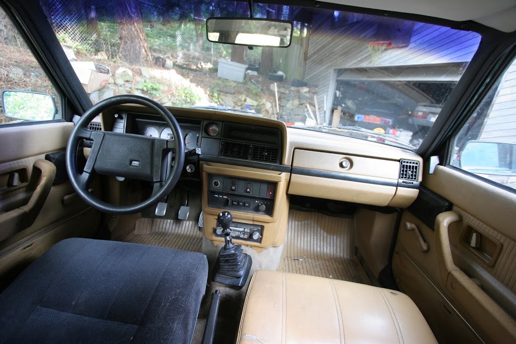

In preparation for swapping Cameron's black interior into my car, I also ordered a bunch of RAAMmat sound deadening and Ensolite foam for the car. I wanted to make the car much quieter than stock, and from the research I did it sounded like this stuff was one of the best performance per dollar products you could buy. The guy that runs it seemed very knowledgeable when I talked to him on the phone as well. I also sold my super sweet tan Recaro SE seat to Travis (F13ND), and swapped in one of the gray cloth seats I bought from Cameron:

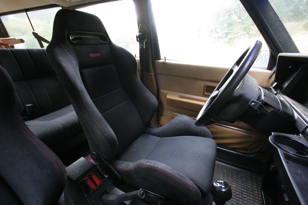

I needed some good seats to match the black interior, so I found a set of JDM ITR Recaro seats in black with red stitching on craigslist and bought them:

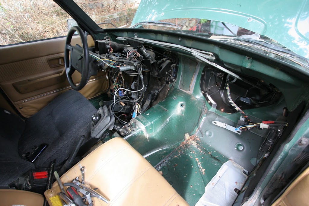

Then I tore everything out of the car so that I could install the 1993 HVAC box in place of my tired stuff. Also at this time I replaced my wiper linkage that had bound up and destroyed two wiper motors with the linkage I got from Cameron when I bought the rest of his stuff.

And modified the seat brackets on the new seats to bolt into the factory positions:
And the half-way finished product:
At this point the car was a lot of fun to drive. Until I bought my Evo I never realized how important good seats were, so I knew that was one of the parts of this car I needed to drop some coin on. The JDM ITR seats hug you nice and tight, a lot better than the Recaros in my Evo do! I was waiting on doing the door sound deadening and installing the nice gray door panels until I purchased some speakers for the front and rear doors, which I haven't done yet, so that part of the interior project is still in progress. For the rear/trunk area I am going to line the floor with some black ABS sheet so that it is nice and easy to load and unload heavy and dirty parts back there.
