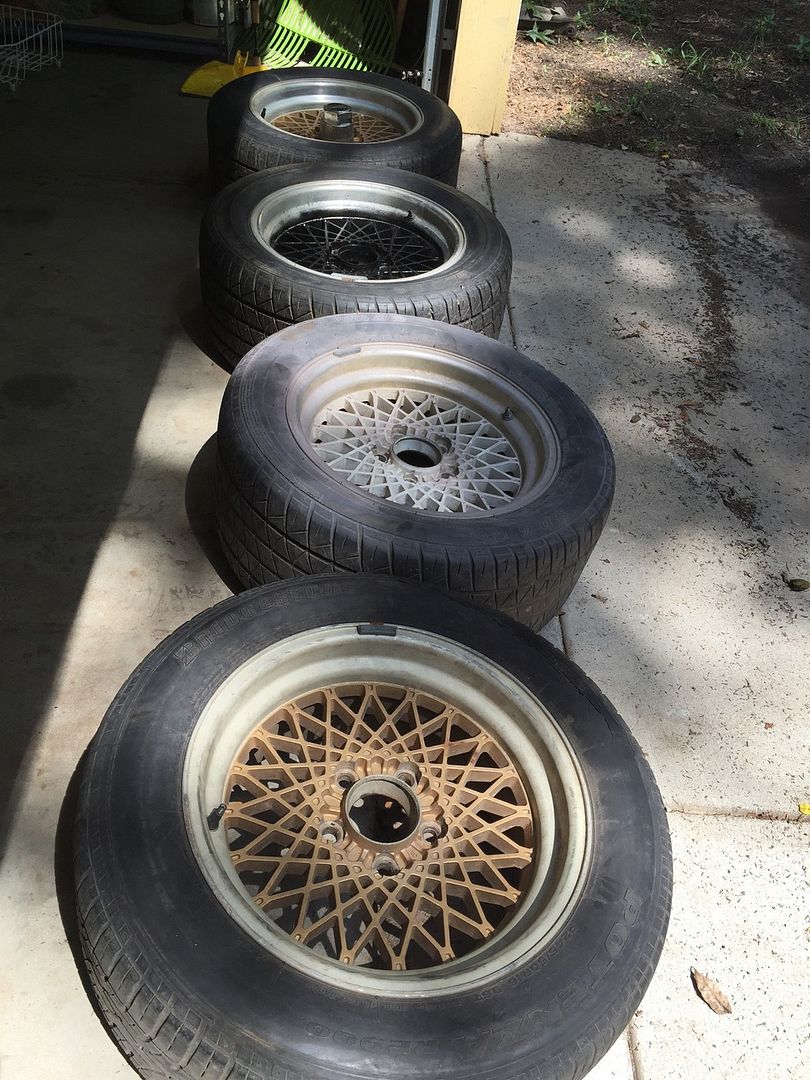

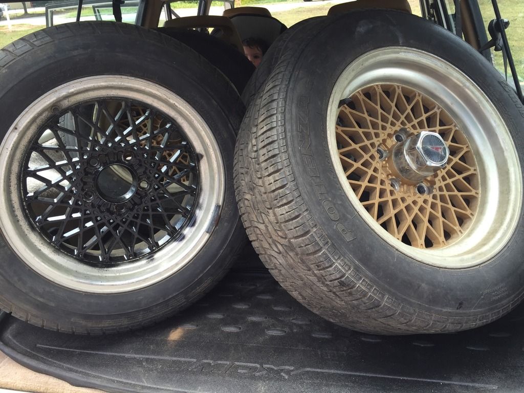

Just picked up a squared ET16 set for cheap. I have some restoring to do. PO decided to spray paint one wheel black and another white. Hopefully it shouldn't be too hard to remove it
Looks good.
