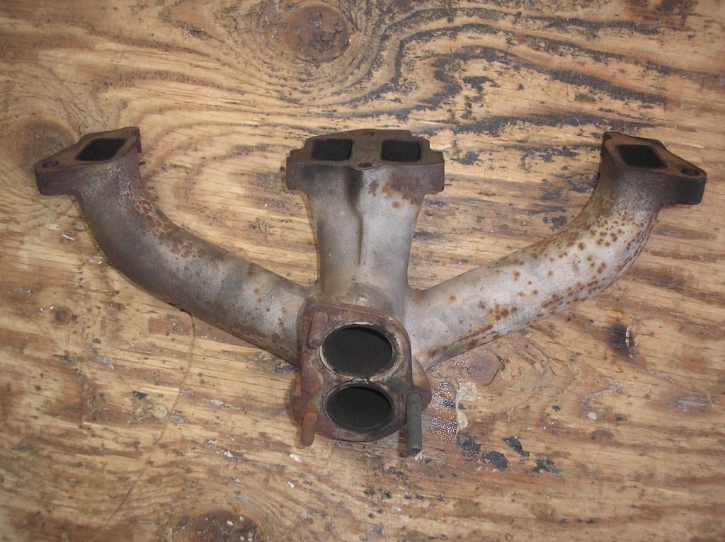

Reportedly the later EFI exhaust manifold flows the best.

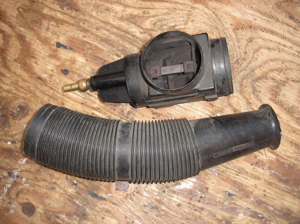

Aren't you going to run the intake out into the fresh air?
I thought about it but I heard the incoming air needed to be slightly pre-heated? I don't know if there's any truth to that. Plus there isn't much room for all that behind the grill area. Although when I did consider it, I had imagined using modified IC piping so it would have less of a tendency to become brittle over time.
It's mostly useful for warm up in a cold climate.
The bi-metallic spring is designed to regulate the incoming air to 80?.
Generally the spring is removed, and the flap caulked in place.
Like the later style pre-heat stuff it's prone to failure, with burned B20 exhaust valves being the result instead of a fried AMM.

Do you have a picture of all of that hooked up in a 140? I can picture it in my head but I'm more interested in size reference. I still might go with an intake through the front and into the grille area. Although I'm not sure of the benefit I'd get from that other than it looking pretty neat :e-shrug:
Cold air and a little positive intake pressure is always a good thing.

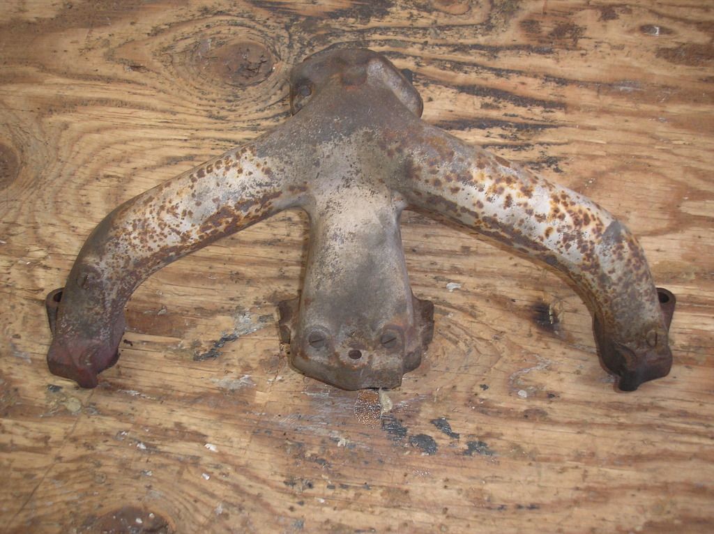

I mentioned on the previous page that it's probably better than most headers. Is a Stahl a 4:1 style header? The stock manifold is a 4:2:1 style, properly pulse paired, and with good lengths on the pairings as well. Most high dollar 4:2:1 headers use similar lengths, just larger tubing diameters for highly modified engines. most 4:1 style manifolds are jsut for the looks.
For the record, i have a 4:1 header on my PV too. But I was replacing the single downpipe style B18 exhaust manifold which flows poorly. And I only paid $73 (shipped) for the thing, brand new, from Amazon.com. Patriot brand, came with a *much* better looking collector than internet pics would lead you to believe, very solid functional chunk of tubing.

What does the header look like?
