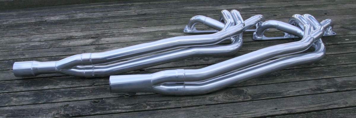

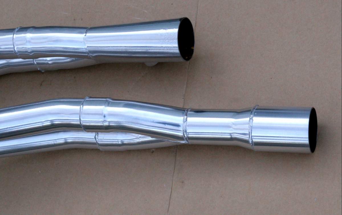

Not endorsing the seller (buyer beware), but here's a look at John Parker's (v-performance) new 4:2:1 header. He developed a new one, and says it's dyno proven to increase HP vs. his older one. The interesting part is that the newer one has a smaller section of pipe at the 2:1 collector, then opens up after that. Makes me think that even if the stock DP's 2:1 collector is a little smaller, it's still good to hook it to a larger exhaust. Exhaust gas velocity through the 2:1 collector area and then on into the more open tubing beyond.

That looks nice but John Parker won't see any of my money, just from what I've heard, although I was able to get him to exchange emails with me one time.
I figure with the 122 being so low, using the stock manifold will force me to have a custom downpipe built so they can tuck it as close to the car as possible. That would've been hard to shorten the pre-built header. My plan is to have the downpipe built with 2-2" tubes that collect into a 2.5" all the way back. I'll have it built with no muffler while I decide what I want to put in it eventually.
