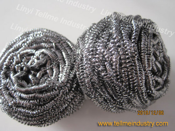

if you cant afford a vented oil cap then take off your oil cap and put one of these on
The scratch pad won't solve anything unless it gets ingested into the valvetrain, at which point your other problems will seem minor by comparison. A vented oil cap might work, but there's not really a good place to tee it into the stock system. The hoses will probably be so brittle that they'll break if you try to remove them. It's best just to bite the bullet...
