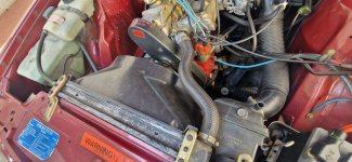

Hi, our 1981 B19A has still ALL the entire cooling system original, except the (second) water pump changed last year because had a little leak.
Has 107'000km, so even if old of age, all parts have never been stressed: major wear is from time han from mileage.
No leak of any type: I've made 450km on the on a scorching day on the highway, mountain passes, winding roads in the middle of remote hills without having lost a single drop. I checked with a pencil mark on the reservoir the day of departure, and the morning after I returned, it hadn't moved a bit. I was perhaps too thorough with this test for a 50-year-old car...:ROFLMAO:
Radiator was checked when changed water pump and my indy said: "this is the original one, has no leak. If you change it as PM you won't find another quality one like this today. Leave it there". I know for sure that was removed and flushed in the mid of the 90's for a water pump failure due to an incorrect coolant/mixture which led to some sludge, I don't remember exactly because I was a child, but it was necessary to empty everything. It was the last time my father took it to an official dealership. Thanks Volvo :cautious:
I honestly confess that opening the hood and seeing everything just as it left the factory is still a great feeling today: if necessary, I would obviously change it, but if it were just a qualm, I would like it to stay there... tell me if I'm crazy/idiot or not.
For the rubber parts I think that preventivate maintenance is instead useful. What are the parts that are mandatory to mantain it in perfect shape, apart from the obvious 2 big rubber hoses?
I've found that schematics tha should be for our car but I don't have any PN for reference and I don't know if some parts are useless to change.
thanks in advance to who wants to help me :D

rubbers seems ok, soft at touch, no visible cracks or hardened parts but...old.
I'm in Italy, our B19A was a version for Italy due to the tax for engines over 2 liters af the time.
I can viasually see 4 rubber hoses: 2 from reservoir, 2 from radiator but I honestly don't want to go "blind changes"
That engine looks very nice and clean.
I wouldn't be too worried about it, given how everything looks and how the car behaved on your long drive.
I think the best course of action is to do a nice flush of the system, with distilled water maybe even run some thermocure for a little bit. When you drain everything out, inspect the hoses internally for any signs of failure. I pulled an upper hose off of a family members car during a coolant flush, and found the inside looked like an elephants skin, wrinkles and flaking apart. It looked fine on the outside though. If there is no flaking or disintegration inside, no cracking when you flex the rubber, those hoses should be fine to re use. I would make sure to check the heater core hoses more carefully, those are an often neglected item. Your engine bay looks very clean though, so I don't think you have to worry about oil leaks causing your rubber to become contaminated.
For coolant, I would just use the genuine volvo concentrate and dilute it 50 50 with a gallon of distilled water. Don't use tap or hose water, since the minerals inside will build up inside your cooling system and eat the aluminum.
The rubber and other parts volvo used seems to be a very high quality that lasts a long time. Yours seem to be no exception. Keep using high quality parts/fluids and you will have many more miles ahead of you.

coolant was flushed when changed water pump. I plan to do it again in a year (maybe in 2027) to be sure. What was the original color of the coolant? Volvo OE is the same today?
The heater core hoses are always the ones I fear more, in every car. Are easily reachable/visible in 244?
Volvo OE formula is blue right now. As long as you don't mix coolants I have never heard of an issue caused by incorrect coolant formula. Personally I used generic green 50/50. Realistically I would recommend you stick with whatever you have been using since it seems to have been working with no issues.
The engine to firewall hoses are reachable and visible but actually replacing them without removing other stuff (intake manifold, etc) may be difficult depending on how long your arms are and how flexible you are.
They are at the back right corner of the block, around the bottom of the head. One is attached to the head, one is attached to an L-shaped pipe which goes around the other side of the engine to the back of the water pump. They both go to a pair of pipes fitted into the firewall. On the other side, if you take off the lower left side cover on the center console you should be able to see where they go from there towards the heater core and heater control valve.

I pulled the radiator from my '82 244 Turbo and took it to a radiator shop to have them pressure test and clean its coolant passages via dipping in the boil-out tank "just to be sure."
per AI:
"A radiator shop "boils out" a metal radiator by submerging it into a large, heated vat filled with a caustic alkaline chemical solution (the boil-out tank). The hot solution—heated near the boiling point—loosens, dissolves, and removes heavy rust, scale, grease, and old sediment trapped inside the core."

The history of the car is well known, being acquired new by my father in 1980 and always driven by him.
The cooling flush as written was done when changed water pumps, last one 2 years ago with second water pump.
It has never been totally "sit", but driven for little distances, expecially the last 10/15 years. Maybe once a weekend, but for short trips. The coolant is clear and transparent, so was the water pumps that makes me think there is not that much "gunk" around but, who knows in the block?
"By hands" I don't feel any particular temp discrepancy: when hot, it cools with the fan, when normal, it sits just in the middle of the needle and the engine doesn't seem to have any temp differencies in the hoses (checked when investigating water pump and thermostat).
Just this weekend I went for another "short" trip in the mountains, 150km between 11am and 3pm: average outside temperature 38/40°C, very, very high external humidity. Even on the most challenging sections, I didn't notice any movement of the needle, except by half a millimeter because I was careful.
The flush is something I want to do as a PM to avoid issue but I don't know if being too "aggressive" will be the best way. I feel (maybe being wrong) that a high pressure hose if not specifically needed/not to solve an issue might be a little invasive
