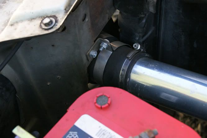

I removed inatke muffler, and I did cut a piece of that aluminium pipe which is used in heating purposes. Piece of that pipe found it's place where this muffler was. Rest of the heating pipe goes under car, so that it can't take water inside it.
Pics aren't good but u might get the idea of it.
This is the best one so far. It is also how I did it on my 240 back when I still had it.
