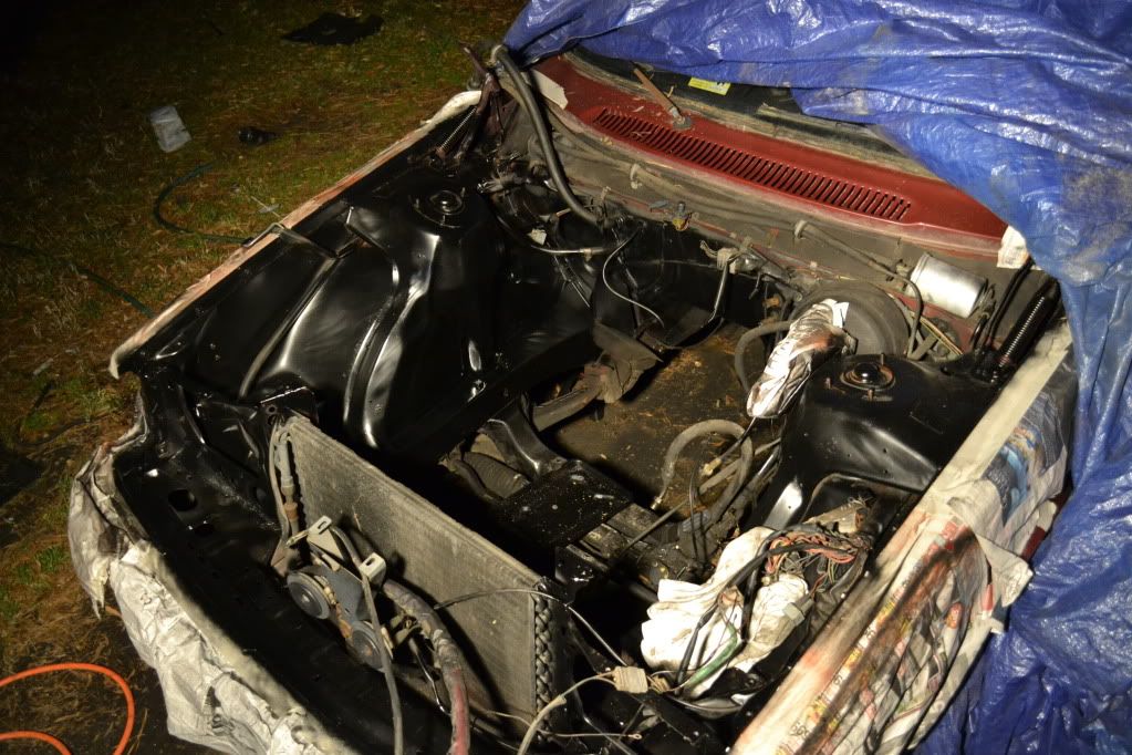

FILTHY! new coat of paint probably tomorrow.

got the bay painted, and put in some new window scrapers.

got the bay painted, its better than it was, but not what i wanted
luckily its just a DD, its not meant to be perfect :-P
