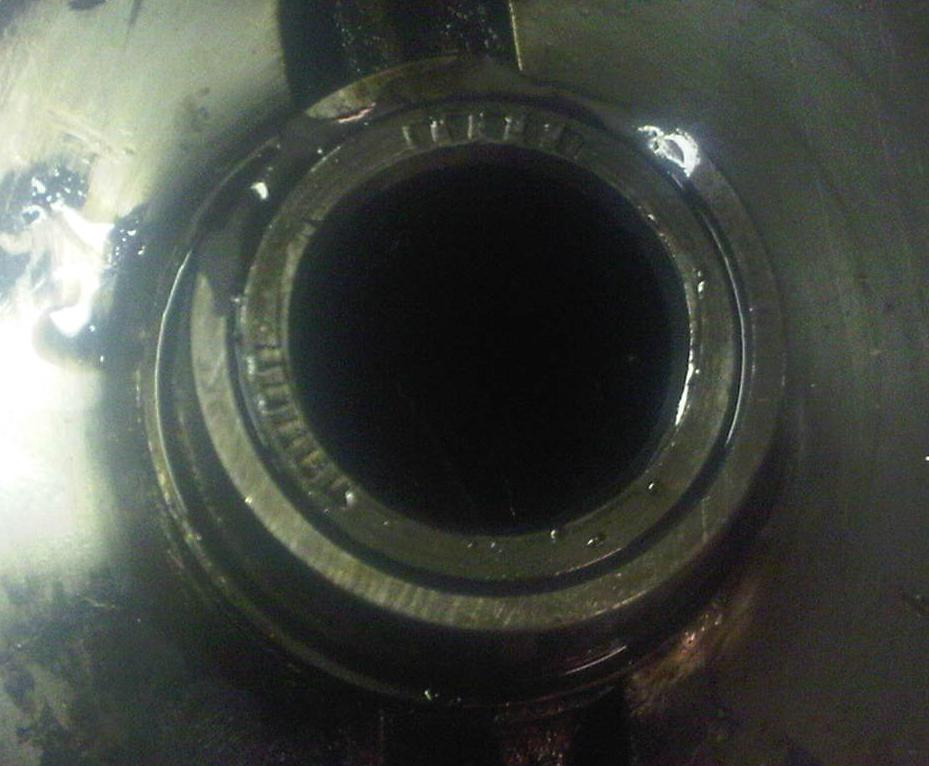

The carrier bearings seem to be stuck on the carrier. I started
with the ring gear side and the bearing will not pull off. The
roller cage got completely mangled to the point where I cut it
off, but the inner race refuses to budge. I even tried pulling
from the top flange on the inner race; the flange shattered where
the puller was grabbing it. Heat did not help.
The bearings on the G80, and on the last axle I did this swap to
pulled off with no trouble.
I'm trying to remove the bearings from the open carrier to
retrieve the shims. I have brand new bearings to press onto the
G80 carrier.
The end of the carrier has two sets of four square impressions on
it, almost as if it had been peened with a machine to lock the
bearing on. I've not seen this before.
