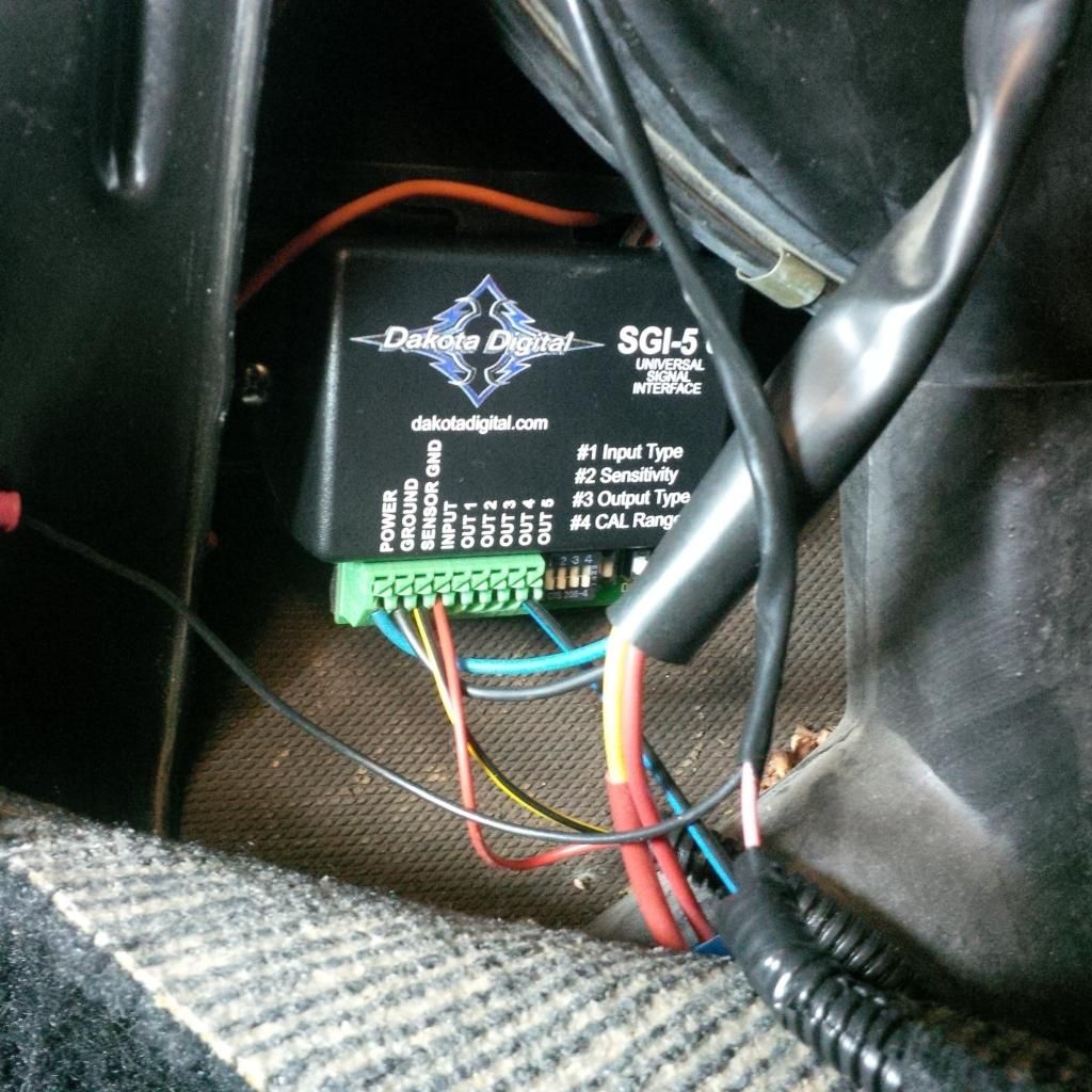

Can the VSS be used to drive an electronic volvo speedo and give the LH2.4 the right signal?
Canuck
Frozen Garage Hell
Feb 1, 2006
Lethbridge, AB, Canada
ahhhh, I knew I was retarded.
No - the VSS sends an unclipped AC signal (8000 pulses per mile). LH 2.4 needs a digital pulse. I'm running a converter from Dakota Digital (SGI -5C). I've mounted it on the side of the centre console - fits and works perfectly. Fuel cut and idle works as it should.
