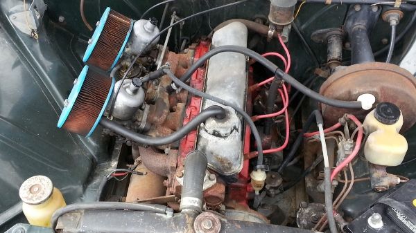

Engine bay. It's a '68, so it has a B18b with two SU's. When I got it:
Engine Bay Rev. 1:
Engine Bay Rev. 1:
