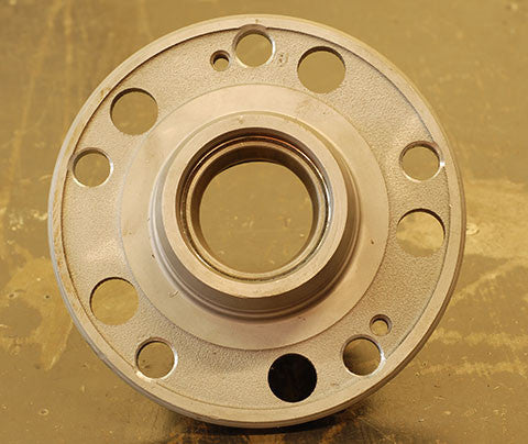

to the point of the hub redrilling, would it be reasonable to get rotors with the exact same dimensions as the ones in the kits except for having the “new” bolt pattern?lil update as far as what i’ve found:
found some decent wheels (kansei KNPs) but the only 5x108 option i’ve seen is 18x8.5s, and i was gunning for 17s as i think 18s can look a little goofy, plus tire fitment would be easier with 17s. someone here mentioned STS coming up with a rear brake kit to match their front soon, and i was wanting to hop on that as well. i wanna keep the 5x108s to keep all the aftermarket brake stuff i’ve been seeing, but i’m wondering if it’s worth having the hubs redrilled for a more popular bolt pattern.
