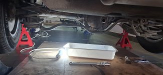

2) DIFFERENTIAL
the differential care wasn't ever opened till 1981 (car is in our family from new). Car ha 108.000km so the fac that there wasn't any "metal shavings" didn't surpirse me a lot, but the good thing is that was almost full. I had little oozings on the bottom, but nothing that can think a bout the gasket so I plan to refill it. B19A engine, non limited slip diff. Any guidance on torquing the two bolts?

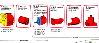

4) GEARBOX OIL car is a manual, 4-speed+overdrive. Some little drops around a bolt, but nothing (still) worrying. Fot the gearbox I don't know if it was ever refilled or not, and if yes... I don't know what oil was used. Gearbox is fluid, every gear change is smooth, overdrive works as it should. I've read on the "green books" I should use a "Type F" ATF oil, but searching onlince I can't find nothing with that specs.
Can you suggest me a right one to search?
Is ok to refill or better to remove all?

4) I don't think the Type F specification is correct for the gearbox: perhaps for the overdrive, you can see it's a separate unit. From what I can see, the 4-speed part of the gearbox takes the same fluid as a later 5-speed M47.
there is a separate oil circuit for overdrive?
As far as I know, my gearbox should be an M46 (4 speed+ovd), that requires ATF-F. Same says skandix with my VIN.
Am I wrong?
@shoestring here's my differential plugs: don't thinka copper washer can be any useful :ROFLMAO:
and, about the gearbox, M46. On the picture above I understand I need a single oil type...
No, the same oil is used for both overdrive and the main gears. Which is why it specifies Type F. Type F does not have friction modifiers which can cause issues with the synchros, but it still works well with the OD clutch.
Here's an old thread on it.
If you can't find ATF type F in your country, I'm a little surprised. However there are a couple of substitutes suggested in the old thread if it's unavailable.
thank you too :) this was my doubt.
I've found only ravenol ATF type F, very pricey (25€/lt). Seeing there, I need 2,3 lt so I need 3 of them.

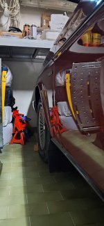

last (I hope) stupid question.car is on 4 jackstands, differential is now free. To fill it and get the correct level, is it better to raise with jack it to a more horizontal position or can I leave it dangling like this? Don't know if there is that much difference but...
You can fill it like that as long as the car is mostly level. The axle doesn't really pivot much as the suspension moves so the fluid level will be very nearly the same whether it's at normal ride height or hanging like that.
