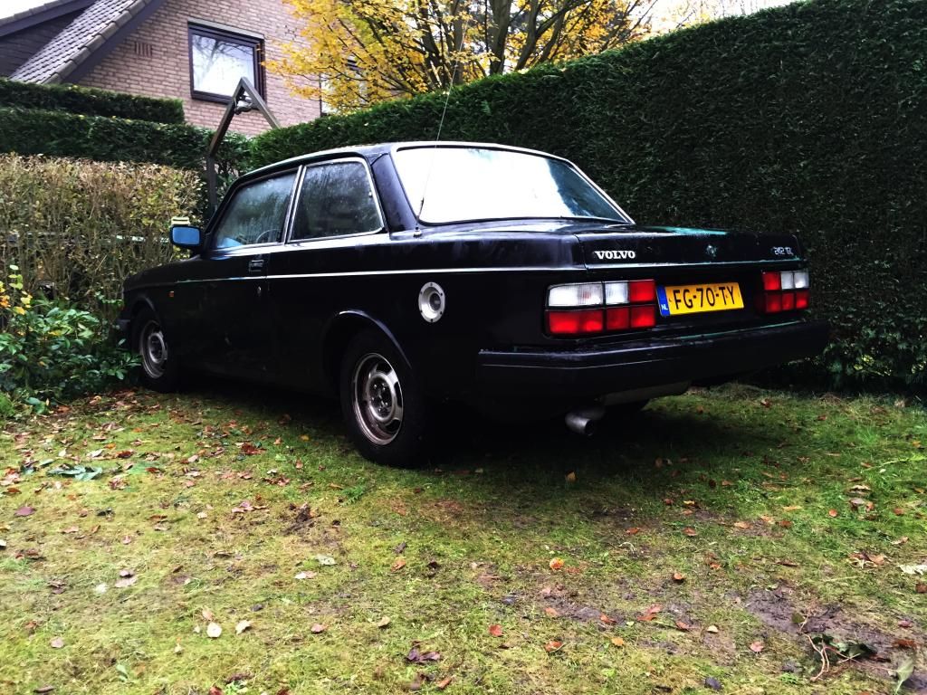

In the many months looking for one I suddenly came across one which looked decently enough to be a good base for a project. I didn't hesitate a second, called the owner and picked it up after a thorough inspection.
It's a 1979 242 GL with a B230E engine and M47 transmission and extra algae and moss
Washed off the algae and moss with a high pressure cleaner
Used to be green

To bad someone painted it black, and that hideous gas cap on the wrong side.
Going to be fun to se what will happen to it :)
Nice history!
Im also busy with putting a 940 Drivetrain in a 242, but i'm running a M46.
any idea why there is a fuel-cap on the left side of the car?
I know right, but it doesn't matter. It'll get a nice paintjob eventually.

The gas cap was ''American style'' according to the previous owner, I already took it off since it has no function anyway.
