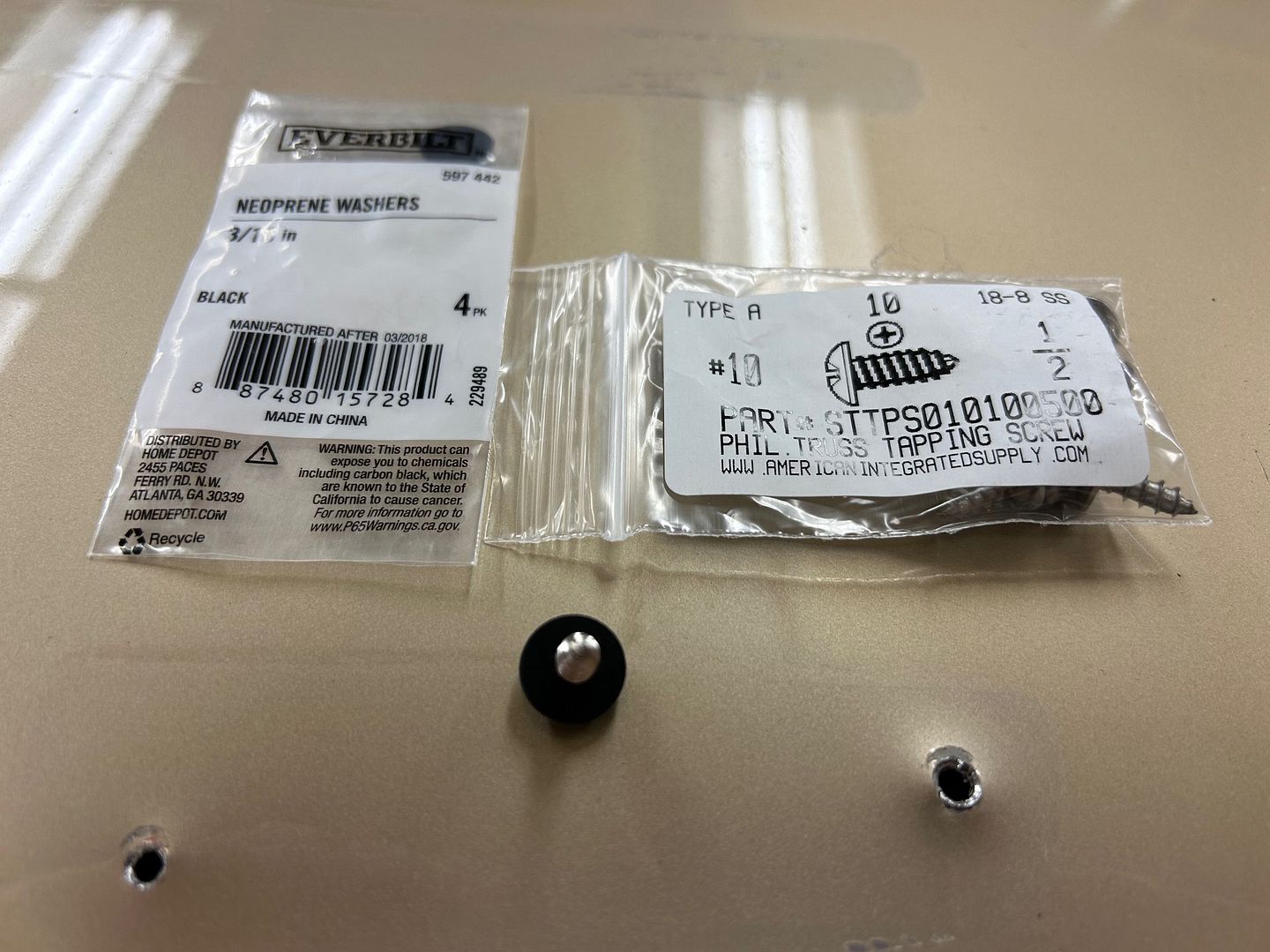

This is the "spacer" in the roof that the roof rack mounting screw goes through. Anyone know what size it is? It's just a threaded tube.
Turns out that the hole is M10x1.5.
So I bought stainless button head screws and neoprene washers and went from this:
To this:
Nice thing is I got 40mm long bolts which means I can make or modify the stock rails and make them removable.

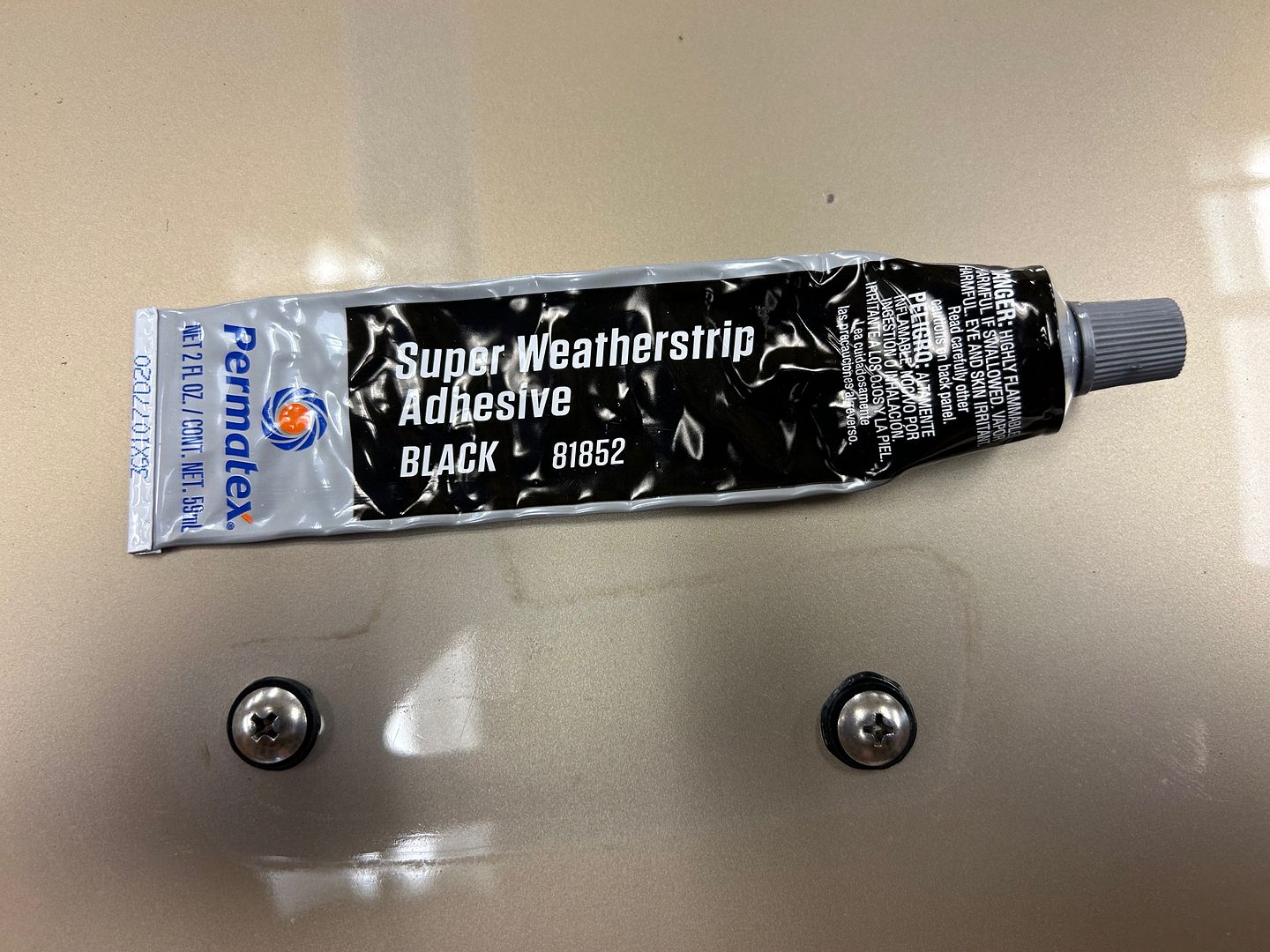

I removed the rack off my 90 745; presumably the 9 series are identical. Mine simply used a stainless steel sheet metal screw and some sealant around same. I choose to recycle mine as I like the long roof smoothness.... to each his own.
I used a tiny rubber gasket along with weatherstrip adhesive (black) to ensure the screws remained water tight..... the IPD plug kit is a joke, and they disintegrate within a couple years of sunlight. Further details in my wagon thread.
