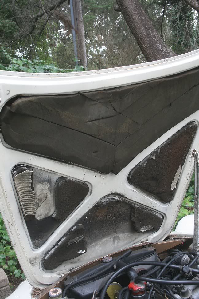

Ewww ugly falling apart hoodliner!
That's how most of the body seals look....
